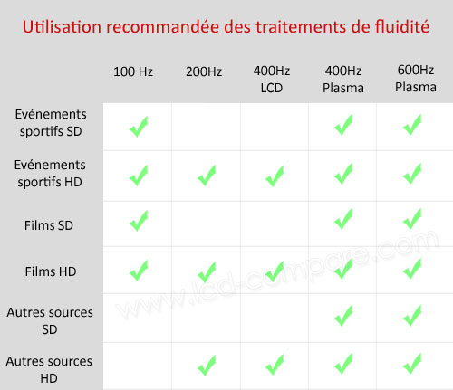

prantslased on püüdnud natuke seletada seda "Hz-teemat"
link lehele
Spoiler Spoiler Spoiler
The fluidity of a TV is its ability to display moving images cleanly and precisely.
It depends on the refresh rate of the TV, ie the number of images that the TV can display every second.
This rate is measured in hertz (Hz), for example, a 50Hz TV broadcasts 50 frames per second.
In order to limit the afterimages (persistent), flicker and improve accuracy, it is possible to increase this frequency with a "processing flow."
This is based treatments or to add new images between each image, or to add existing duplicate images or display an image "black".
This added technology image represents the fluidity treatments, not to be confused with the melt index that was invented him for "inflating" the fluidity treatment values and that is not always representative of its function real. Everything is explained later in this folder.
