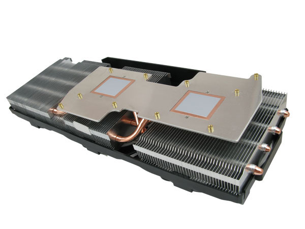

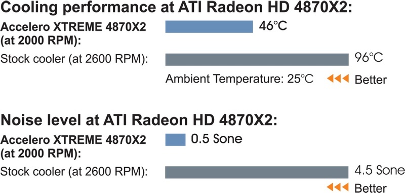

4870X2 meestele:
Arctic Cooling Announces the Accelero Xtreme 4870X2
Spoiler Spoiler Spoiler
http://www.techpowerup.com/85578/Arctic_Cooling_Announces_the_Accelero_Xtreme_4870X2.html
