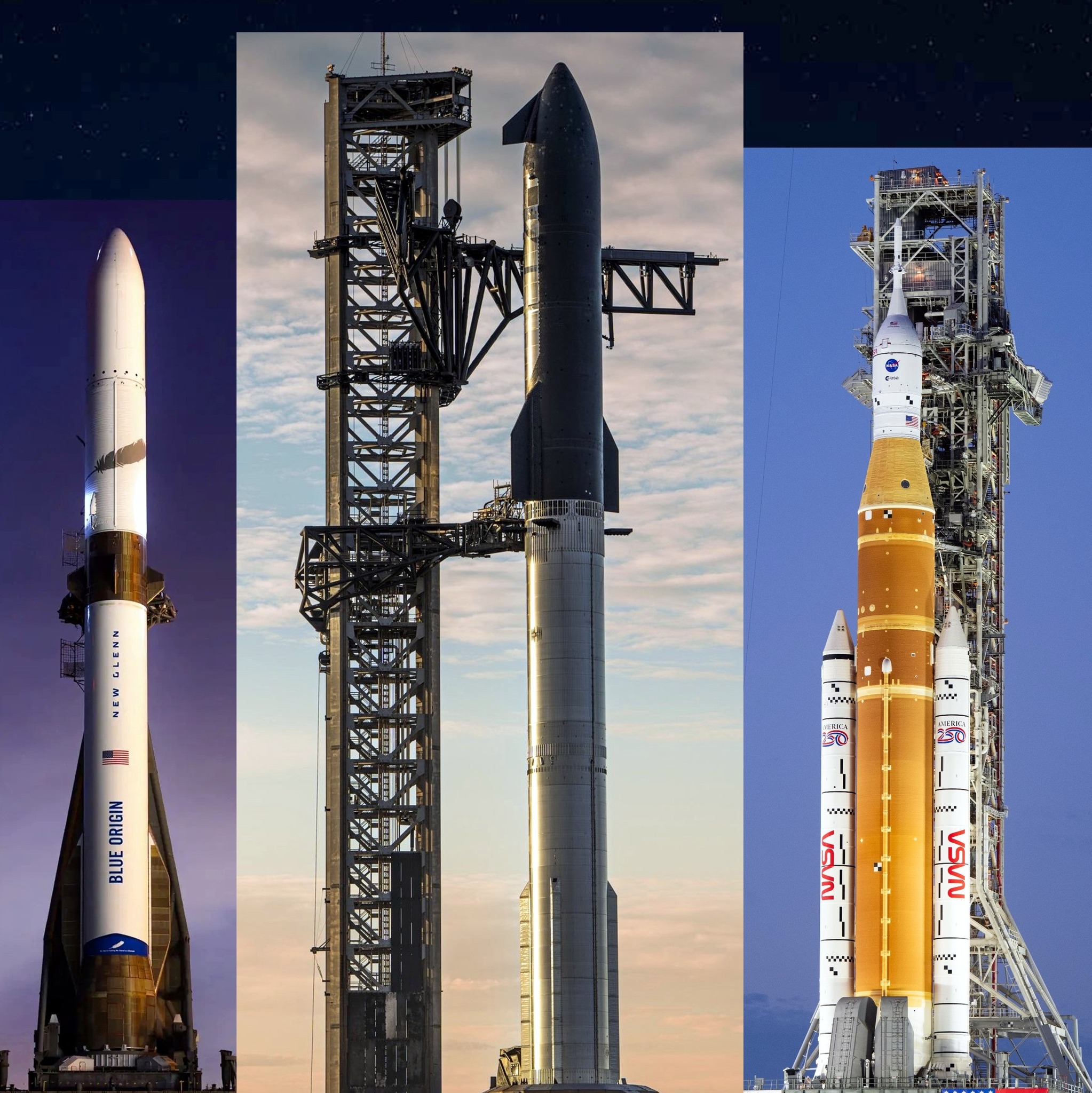

Spoiler Spoiler Spoiler
tsitaat:
If schedule holds, these 3 giant rockets will launch in the next 3 weeks.
From left to right:
New Glenn - satellite launch now, planned for the Moon
Starship - test flight 12 now, planned for the Moon
Artemis - to the Moon and back with 4 crew aboard
Pushing the very edge of our capability as we learn how to more safely & cheaply reach space, to explore all that exists beyond.
