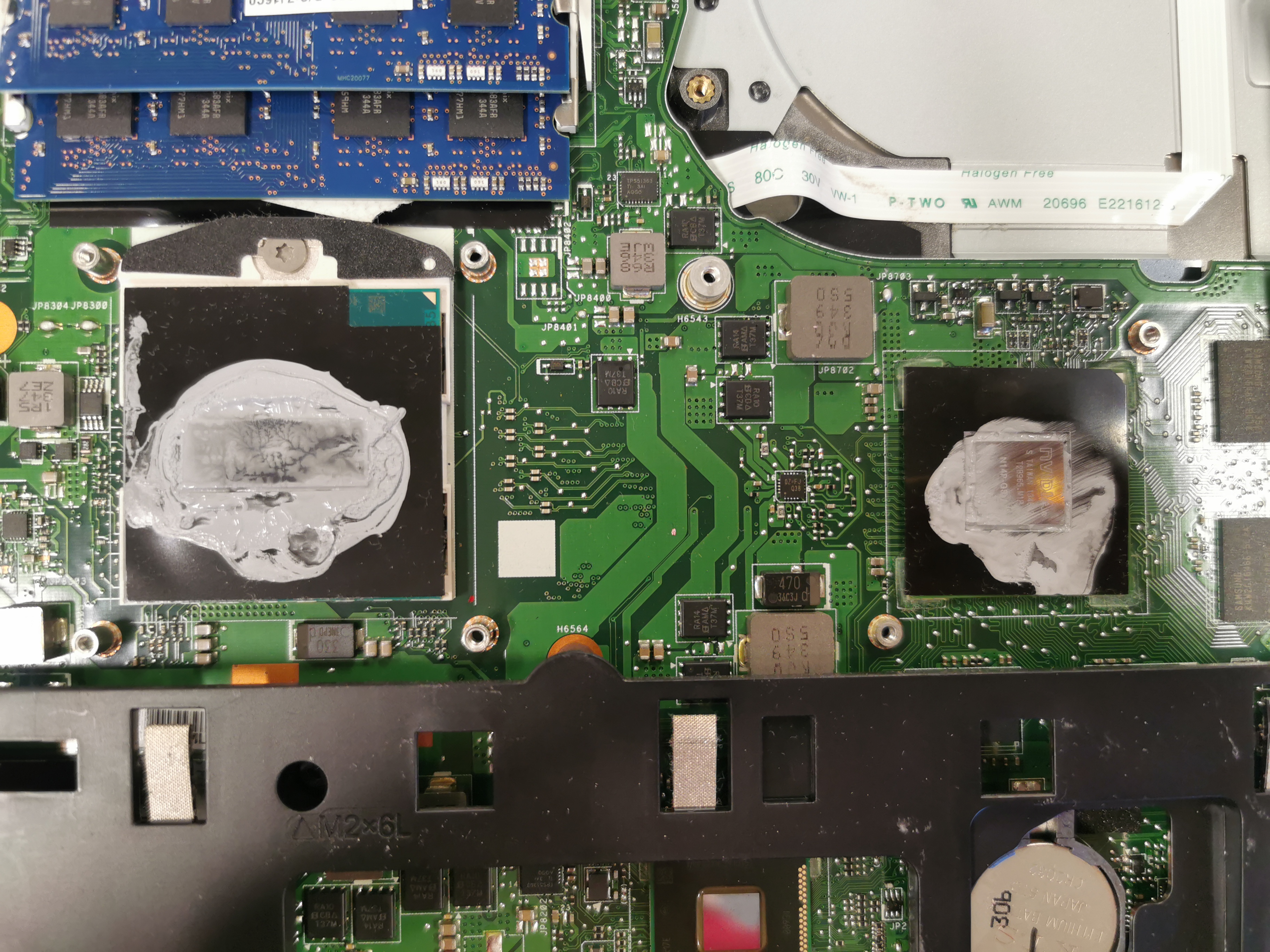

Lenovo Ideapad z710, pastat on tehase poolt pandud kuhjaga
