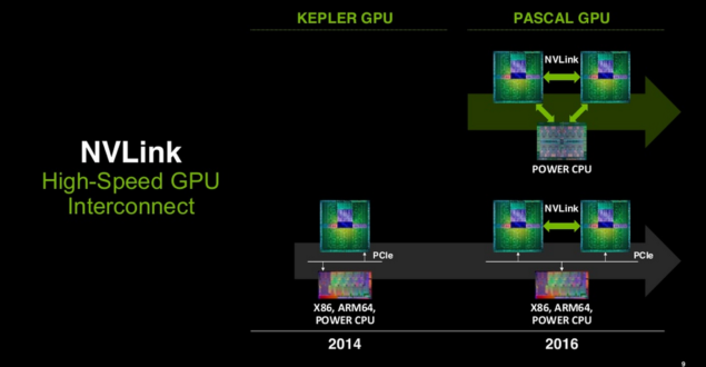

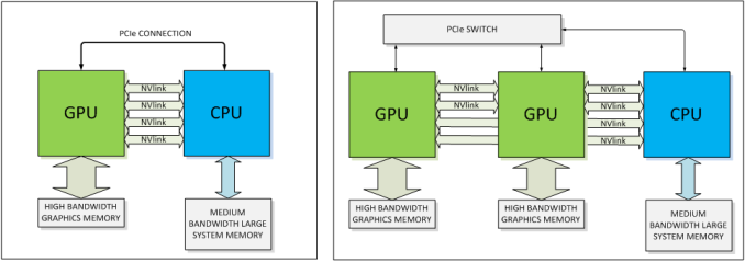

Oodake aasta ja saate mäluprobleemist vabaks:
Unified Memory: This will make building applications that take advantage of what both GPUs and CPUs can do quicker and easier by allowing the CPU to access the GPU’s memory,
and the GPU to access the CPU’s memory, so developers don’t have to allocate resources between the two.
NVLink: Today’s computers are constrained by the speed at which data can move between the CPU and GPU. NVLink puts a fatter pipe between the CPU and GPU,
allowing data to flow at more than 80GB per second, compared to the 16GB per second available now.
http://blogs.nvidia.com/blog/2014/03/25/gpu-roadmap-pascal/

vaevalt küll. unified memory on cudas juba praegu olemas ja kujutab endast sisuliselt mälu(tüki) sisu sünkroniseerimist.
pascali juures olev unified memory note on eelkõige socide suunas, mille siinide üle on nvidial täielik kontroll. ma ei kujuta hästi ette, kuidas nvlink desktopile portuma peaks, kus videokaart üle pci-e süsteemi küljes on.

http://wccftech.com/nvidia-planning-ditch-maxwell-gpus-hpc-purposes-due-lack-dp-hardware-update-tesla-line-pascal-2016-volta-arriving-2017/

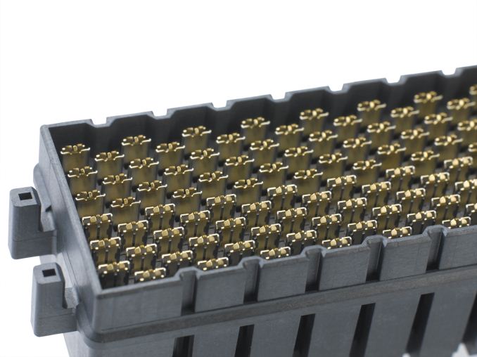

Ilmselt hakkame ka nägema NVLink emaplaate mezzanine connectoritega:
http://www.anandtech.com/show/7900/nvidia-updates-gpu-roadmap-unveils-pascal-architecture-for-2016
Kommentaarid: 41 loe/lisa Kasutajad arvavad:  :: 0 :: 0 :: 39

tsitaat:
Meanwhile, though NVLink won’t even be shipping until Pascal in 2016, NVIDIA already has some future plans in store for the technology. Along with a GPU-to-GPU link, NVIDIA’s plans include a more ambitious CPU-to-GPU link, in large part to achieve the same data transfer and synchronization goals as with inter-GPU communication. As part of the OpenPOWER consortium, NVLink is being made available to POWER CPU designs, though no specific CPU has been announced. Meanwhile the door is also left open for NVIDIA to build an ARM CPU implementing NVLink (Denver perhaps?) but again, no such product is being announced today. If it did come to fruition though, then it would be similar in concept to AMD’s abandoned “Torrenza” plans to utilize HyperTransport to connect CPUs with other processors (e.g. GPUs).
loe: kui desktopist räägime, siis ei amd ega intel hetkel ei koopereeru.
gpu-gpu jah (aga tehnilistel põhjusel ilmselt mitte desktopil kui just mingit advanced sli silla laadset õudust ei tehta või plaati imekirveks ja -spetsiifiliseks ei aeta), cpu-gpu nvidia enda armidel ja antakse nvlink poweri disainimiseks.
spetsraud, computing, superarvutid jms on teine lugu.
