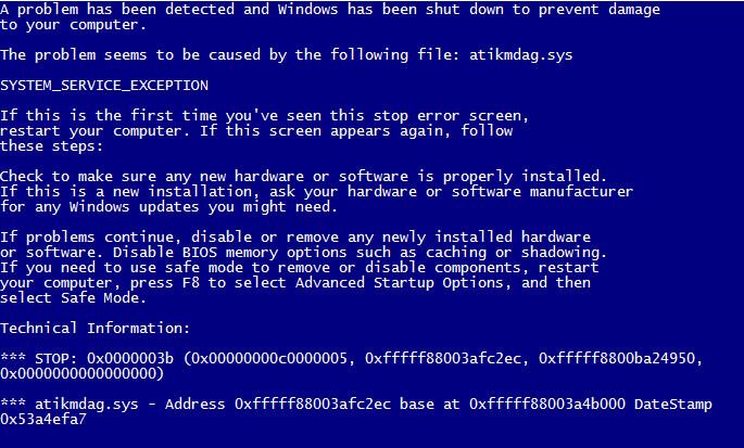

sõnum 12.08.2014 20:55:02 vasta tsitaadiga
Viimasel ajal päris tõsine probleem tekkinud sessiooni taastamisega. Nimelt pärast BSOD-i on sessionstore.js korrumpeerunud (täis nulle ehk siis taastamatu) ja seoses FF enda taasteloogikaga keeratakse ka sessionstore.bak nässu, kuna ei kontrollita sessionstore.js loetavust ja kirjutatakse BAK fail tuimalt sama hulga nullidega üle. Õnneks paistab, et mina pole ainus kes probleemi on märganud ja parandus tuleb versioonis 33 (hetkel Aurora kanalis). Väljalase 14 Oktoober 2014 (64 päeva pärast).
Bug ise: https://bugzilla.mozilla.org/show_bug.cgi?id=883609
Täpsemalt: https://dutherenverseauborddelatable.wordpress.com/2014/06/26/firefox-the-browser-that-has-your-backup/
Ehk kui praegu on:
sessionstore.js
sessionstore.bak
Siis tulevikus:
sessionstore.js
sessionstore-backups/recovery.js
sessionstore-backups/recovery.bak
sessionstore-backups/previous.js
sessionstore-backups/upgrade.js-[build id]
tsitaat:
sessionstore.js (contains the state of Firefox during the latest shutdown – this file is absent in case of crash);
sessionstore-backups/recovery.js (contains the state of Firefox ≤ 15 seconds before the latest shutdown or crash – the file is absent in case of clean shutdown, if privacy settings instruct us to wipe it during shutdown, and after the write to sessionstore.js has returned);
sessionstore-backups/recovery.bak (contains the state of Firefox ≤ 30 seconds before the latest shutdown or crash – the file is absent in case of clean shutdown, if privacy settings instruct us to wipe it during shutdown, and after the removal of sessionstore-backups/recovery.js has returned);
sessionstore-backups/previous.js (contains the state of Firefox during the previous successful shutdown);
sessionstore-backups/upgrade.js-[build id] (contains the state of Firefox after your latest upgrade).
Seniks aga kes mingil juhul ei taha sessiooni kaotada peaks kasutama: https://addons.mozilla.org/en-US/firefox/addon/session-manager/
