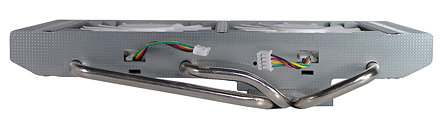

Spire Unveils Slimod VGA Cooler
http://www.techpowerup.com/106214/Spire_Unveils_Slimod_VGA_Cooler.html
Spoiler Spoiler Spoiler
