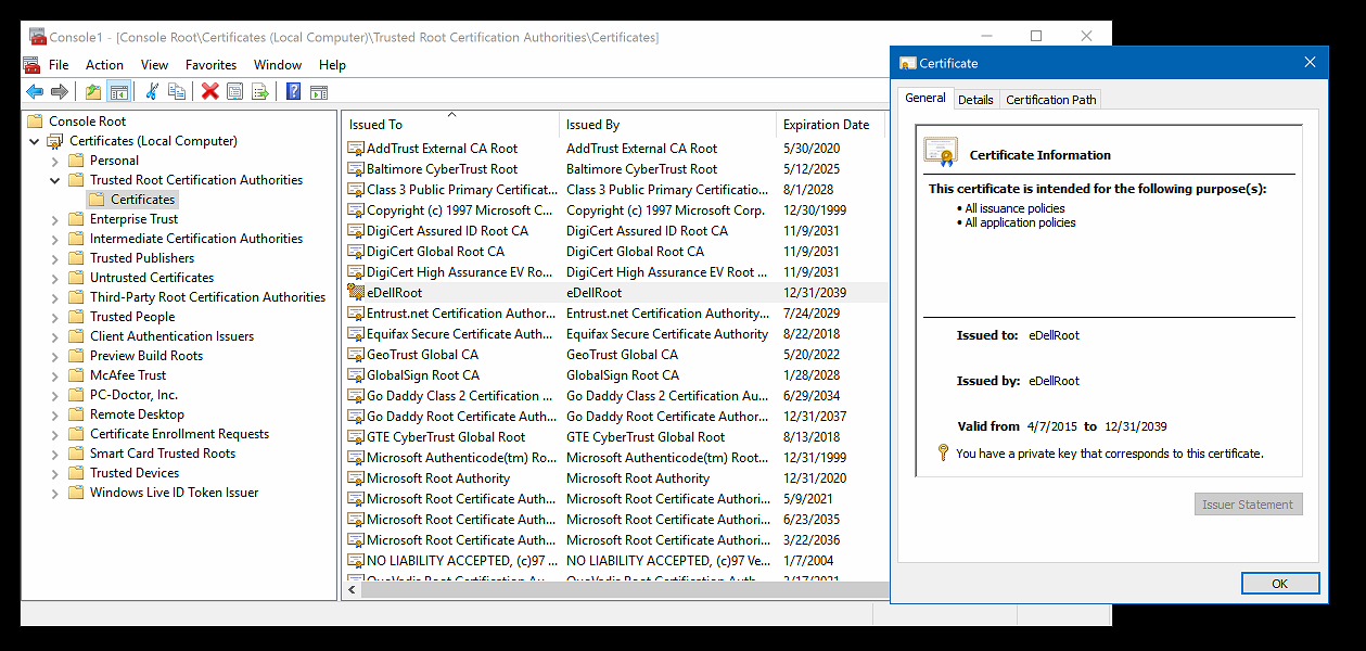

sõnum 24.11.2015 01:20:38 DELL-i tarnis uued sülearvutid iseallkirjastatud juursertifikaadiga vasta tsitaadiga
Populaarse Reddit lehe andmeil on DELL kordamas sama fiaskot, mida Lenovo koges möödunud suvel nuhkvaraga Superfish, kui paigaldas kasutaja nõusolekut küsimata koodijupi, mis võimaldas nuhkida kasutajate järgi. DELL XPS 15 sülearvuti ostnud kasutajad avastasid, et sülearvutid tulid eelinstalleeritud iseallkirjastatud eDellRoot nimelise juursertifikaadiga.
Iseallkirjastatud juursertifikaadiga on võimalik sooritada nn vahemehe-rünnakuid (man in the middle attack) ja andmeid manipuleerida ilma kasutaja teadmata.
tsitaat:
I had a new Dell Inspiron in the office that shipped last Friday (11/21). I opened it and checked it. It didn't have the update, until I installed Dell Updates, and then it did. Screenshots:
http://imgur.com/a/DA6P5
tsitaat:
If you have recently bought a Dell computer and want to see if you are affected by this, go to Start -> type "certmgr.msc" -> (accept on UAC prompt) -> Trusted Root Certification Authorities -> Certificates and check if you have an entry with the name "eDellRoot". If so, congratulations, you've been pwned by Dell, the very company you paid for your computer!
tsitaat:
This means that a network attacker that could intercept their traffic with a Man-in-the-middle attack would be able to read and modify the Dell customer's data without being easily noticed. Normally when an attacker does this, the user's browser throws alarms and big red flags, but any user with this root certificate installed will probably not notice it unless they happened to look at the website's full SSL certificate chain (which casual users rarely do).
Loe lähemalt: https://www.reddit.com/r/technology/comments/3twmfv/dell_ships_laptops_with_rogue_root_ca_exactly/

UPDATE 2: Dell has released a statement regarding this matter along with instructions for how to remove it (download).
Allikas: https://www.reddit.com/r/technology/comments/3twmfv/dell_ships_laptops_with_rogue_root_ca_exactly/
