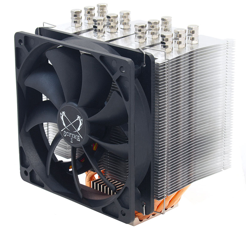

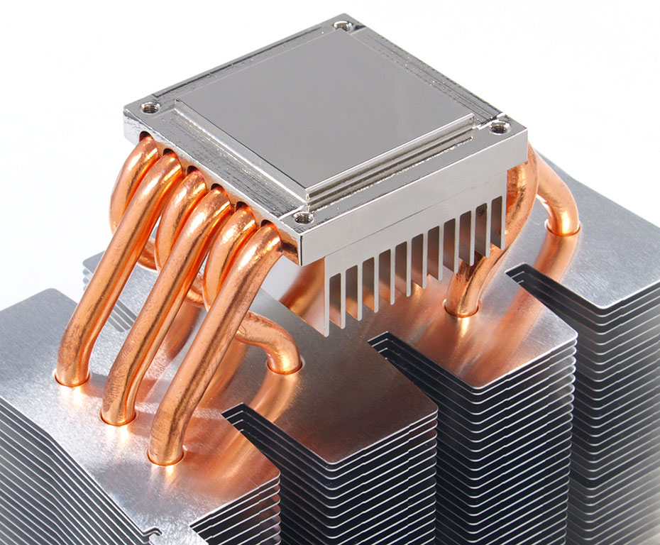

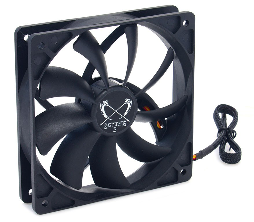

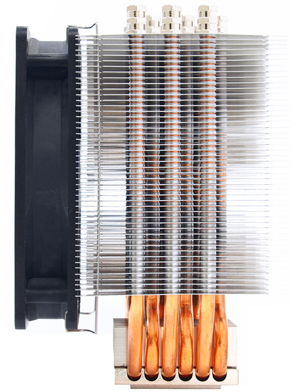

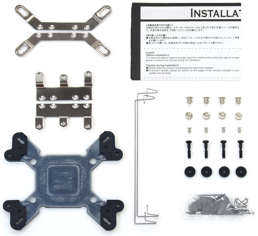

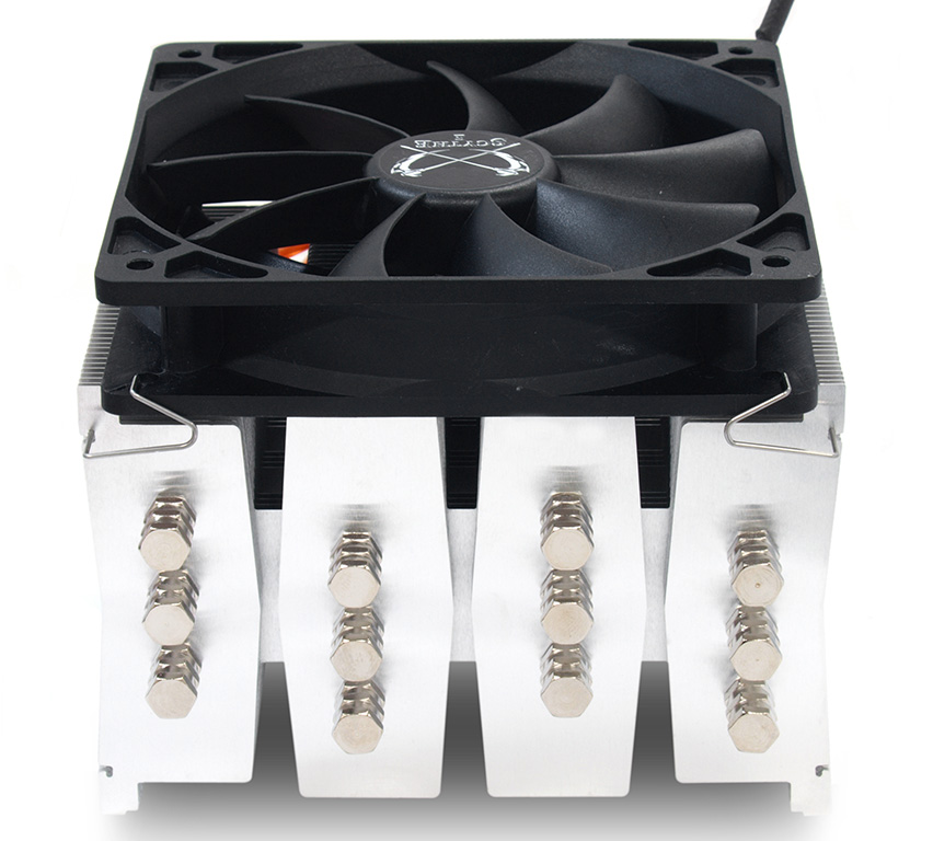

Scythe Releases Third Edition of Mugen CPU Cooler Series
http://www.techpowerup.com/147991/Scythe-Releases-Third-Edition-of-Mugen-CPU-Cooler-Series.html
Spoiler Spoiler Spoiler
