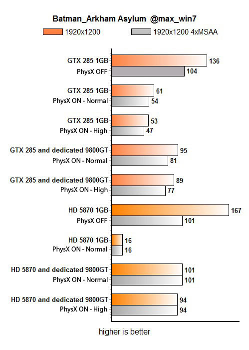

mafia tegin läbi ning esialgu uuesti mängida ei viitsi. aga proovin selle batmani ära
edit: toms hardwares pisike test
Analysis: PhysX On Systems With AMD Graphics Cards
Spoiler
_________________ no shit sherlock |

seal testis olemas ka vastus küsimusele
| redemption kirjutas: |
| Kas x4 kiirus pidurdama ei jää? |
| tsitaat: |
| Clearly, a faster card is slightly bottlenecked by a x4 slot compared to the other two. The difference between x8 and x16 is so marginal that it can be disregarded. A GeForce GT 220 is too slow to notice any difference, as would be a GeForce GT 240 and a 9600 GT. Even the GeForce GTX 285 doesn't suffer that badly. A x4 slot seems to be OK, though a x8 slot is the safer bet for faster cards. |

GT240 on jah piisav, nt PhysX skaleeruvus eraldiseisvate kaaartidega Mafia II-s:
8600GT pidurdab, teistest (alates 240) on ka kasu
| Kommentaarid: 103 loe/lisa |
