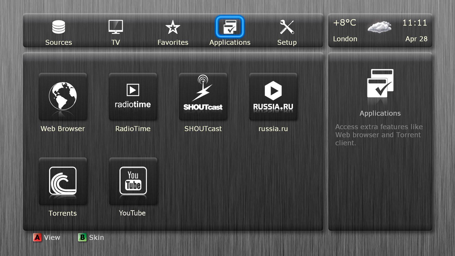

Noid Dune kasutajalliidese ehk uue GUI pildikesi "lekib" ikka aegajalt.
Eilsed on sellised 1920x1080 resoga, et saaks teleris näha, milline see kasutajaliides siis tulevikureaalsuses välja paistab:

* Completely new graphical interface.
- New background image, new icons, more advanced graphics for all GUI
elements (glasses, dialogs, controls, OSD, etc).
- Animation effects.
- NOTE: it is recomended to use 50/60Hz video mode as the default
video mode in order to ensure smooth animation.
- NOTE: animation effects can be disabled in Setup / Appearance.
- Improved text look.
- The space between characters and the width of whitespace character

* New tab-based main menu interface.
- All items from the main menu are now grouped into the
following top-level folders:
- "Sources": locally attached storage devices, configured network
folders, and "Network Browser" function.
- "TV": TV services (when available).
- "Favorites": shortcuts to favorite items (previously
known as "items added to main screen").
- "Applications": all other applications and services.
- "Setup": player settings.
- By default, all top-level folders are now represented as "tabs" at the
top of the screen.
- In Setup / Appearance, the user can switch between the following
styles of the main menu:
- "Tabs": the new default menu style ("tabs" at the top of the
screen).
- "Fodlers": show all top-level folders as regular folders in
the main area.
- "Plain": do not group main screen items into folders (the
same behavior as in previous firmware versions).
* Added widget for showing weather and current date/time information.
- The widget is shown at the top right corner of the screen (in the main
menu only, not during playback).
- The widget can be configured or disabled via "Setup / Applications /
Widget".
- NOTE: When no information is available (e.g. when Internet connection
is not available), the widget shows Dune HD logo.
