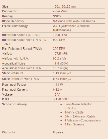

Andmed:
Funktsioonid ja tunnusjooned:
Inglise keeles:
    Anti-Stall Knobs : The NF-S12A’s Anti-Stall Knobs reduce flow separation phenomena in medium to high impedance situations and thereby increase the fan’s stall margin. This means that the NF-S12A is even more versatile than its renowned predecessor and can achieve better performance on heatsinks and radiators.
    AAO Frame : Noctua’s AAO (Advanced Acoustic Optimisation) frames feature integrated anti-vibration pads as well as Noctua’s proprietary Stepped Inlet Design and Inner Surface Microstructures, both of which further refine the fan’s performance/noise efficiency.
    Stepped Inlet Design : Noctua’s Stepped Inlet Design adds turbulence to the influx in order to facilitate the transition from laminar flow to turbulent flow, which reduces tonal intake noise, improves flow attachment and increases suction capacity, especially in space restricted environments.
    Inner Surface Microstructures : With the tips of the fan blades ploughing through the boundary layer created by the Inner Surface Microstructures, flow separation from the suction side of the blades is significantly suppressed, which results in reduced blade passing noise and improved airflow and pressure efficiency.
    Integrated Anti-Vibration Pads : Integrated Anti-Vibration Pads made from extra-soft silicone minimise the transmission of minute vibrations while maintaining full compatibility with all standard screws and other mounting systems.
    Custom designed PWM IC with SCD : Supporting fully automatic PWM speed control, the NF-S12A PWM uses Noctua’s novel, custom designed NE-FD1 PWM IC that integrates Smooth Commutation Drive (SCD) technology. By providing smoother torque impulses, SCD suppresses PWM switching noises and thus makes the fan quieter at low speeds.
    SSO2 Bearing : The NF-S12A features the further optimised second generation of Noctua’s renowned, time-tested SSO bearing. With SSO2, the rear magnet is placed closer to the axis to provide even better stabilisation, precision and durability.

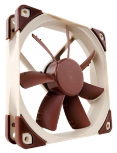

Ventilaatorid ja kaablid
Üleval asuval pildil on hetkel näidatud NF-S12A PWM versiooni .
Nagu ikka Noctua ventilaatorid on olnud, siis ei ole ka see erinev. Noctua ventilaatorite värvikombinatsioonid on beežikad - pruunid, mis jätavad kergelt tagasihoidva mulje tootest.
NF-S12A ventilaator on uuendusliku disainiga, mille labad on teravama nurga all. Labad teevad veel eriliseks nupukesed labade all servades. Need on "Anti-Stall" nupukesed, mille tehnoloogia on selline, et need takistavad õhuvoolul liikumist vastu ventilaatori liikumissuunda ning ei luba õhuvoolul tekitada turbulentsi.
Ventilaatori labasid ümbritseb AAO raamistik, mis on disainitud eemaldama mürataset ning samas ka hoidma ventilaatori võimsust. Raamistiku nurkades asetsevad vibreerimise vastased kummist padjakesed, mida saab vajadusel eemaldada.
Kuigi eri versiooni ventilaatorid on välimuselt ühesugused, siis on ventilaatoritel lisaks kaablitele veel üks erinevus - selleks on voolutarbivus, mis on märgitud toote tahaküljele. ULN versioonil vajab 0.6 amprit ning 0.72W ja FLX ning PWM ventilaatorid vajavad 1.44W ja 0.12 amprit.
NF-S12A kaabel on kaetud põimitud riidest, mis takistab ventilaatori kaablil kahjustuda ning samas ei ole nii silma riivav.
ULN ja FLX versiooni ventilaatorid vajavad 3-pinnist pesa, aga PWM versioon vajab 4-pinnist pesa. Vajadusel kui sul ei ole 4-pinnist pesa, siis saad ka kasutada 3-pinnist pesa, kuid sel juhul ei saa sa kasutada ventilaatori PWM funktsiooni, mis lubab sul muuta ventilaatori kiirust.
FLX (Flexible) versioon annab sulle paindlikuse muuta jahutusvõimsuse, mürataseme või nende vahepealse variandi vahel. Kiirusteks on 1200/900/700 RPM. See komplekt ei anna sulle täieliku kontrolli ventilaatori kiiruse jaoks.
Teiseks versiooniks on ULN (Ultra-Low Noise), mis on mõeldud arvutikasutajale, kes on paljunõudlik madala mürataseme suhtes. See versioon lubab sul valida 800 RPM'i ja 600RPM'i vahel. Ka see komplekt ei luba kasutajal muuta kiirust vastavalt vajadusele.
Kolmandaks versiooniks on PWM ( Pulse-width modulation ), mis on varustatud NE-FD1 PWM IC kiibistukuga, mis tagab sulle madala voolutarbivuse ning madala helitasemega võimsuse.

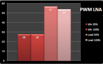

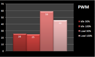

PWM: Katsetasin, milline on müratase, kui ma ei kasutanud L.N.A kaablit ning võrdlesin seda sellega, kui ma kasutasin L.N.A kaablit madala kiiruse peal oli müra tasemete vahe vaevu kõrvaga kuulda. Aga, kui tõstsin kiiruse 100%, siis oli kergelt kuulda heli, mida tekitas ventilaator. Isegi koos L.N.A kaabliga.

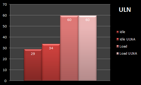

ULN: Katsetasin esmalt, milline on müratase, kui ma L.N.A ja U.L.N.A kaablit ei kasuta. Tulemus oli selline, et mitte mingisugust heli ei olnud kuulda. Siis ostustasin, et kasutan L.N.A kaablit ning proovin sellega, teadsin, et see saab vaid vaiksemaks teha ning sama proovisin ka U.L.N.A kaabliga. See oli suhteliselt uskumatu, kui vaikne saab olla üks ventilaator.

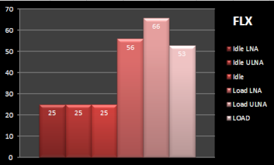

Jahutuse test:
Alustasin sellega, et ühendasin CPU FAN pessa pikenduskaabli, sest liiga tülikas oleks olnud koguaeg ronida uuesti käsipidi jahutuse alla. PWM ventilaatori jaoks kasutasin ma NA-EC1 pikenduskaablit ning ULN ja FLX kasutasin ma NA-EC2 kaablit, mis kusjuures andsid täiesti teise tulemuse. NA-EC2 ja NA-EC1 kaabli vahe seiseb selles, et NA-EC1 on 4-pinnine ning NA-EC2 kaabel vaid 3-pinnine.
Testimine toimus minul nii, et esmalt ma valisin ma ventilaatori ning siis kasutasin SpeedFan'i, et kätte saada selle tegelikud pöörded minutis. Kui see oli tehtud, siis lasin seista arvutil ilma kasutamiseta 5-10 min ning seejärel võtsin SpeedFan'i järgi core0 tulemuse. Teiseks tegin sama katsetades erinevate kaablitega (L.N.A ja U.L.N.A ). PWM versioonil valisin madalaimaks kiiruseks 30% ( tegelikkuses sai ka kiiruse panna 0% peale, mis seiskas täielikult ventilaatori )
Kui see oli tehtud, siis kasutasin Prime95 tarkvara ning koormasin oma protsessori 100% peale, mis tõstis temperatuuri suurel määral. Toimisin samamoodi.

PWM:
PWM LNA:
FLX:
ULN:
